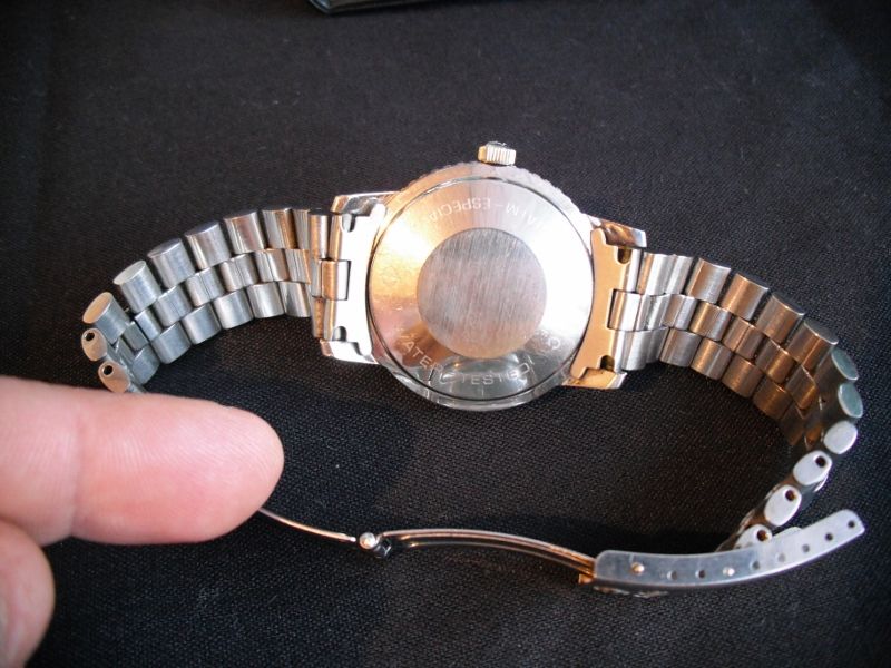

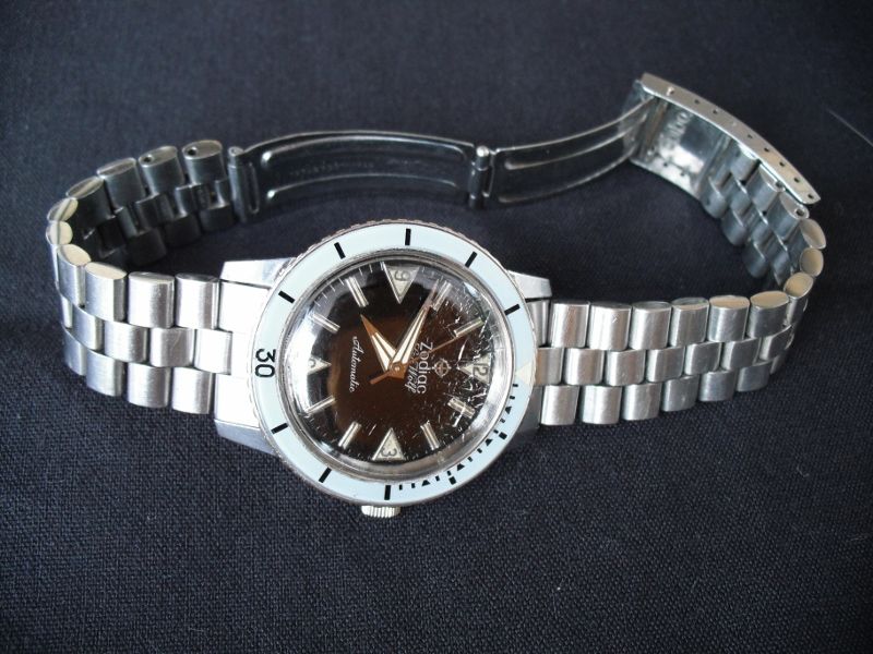

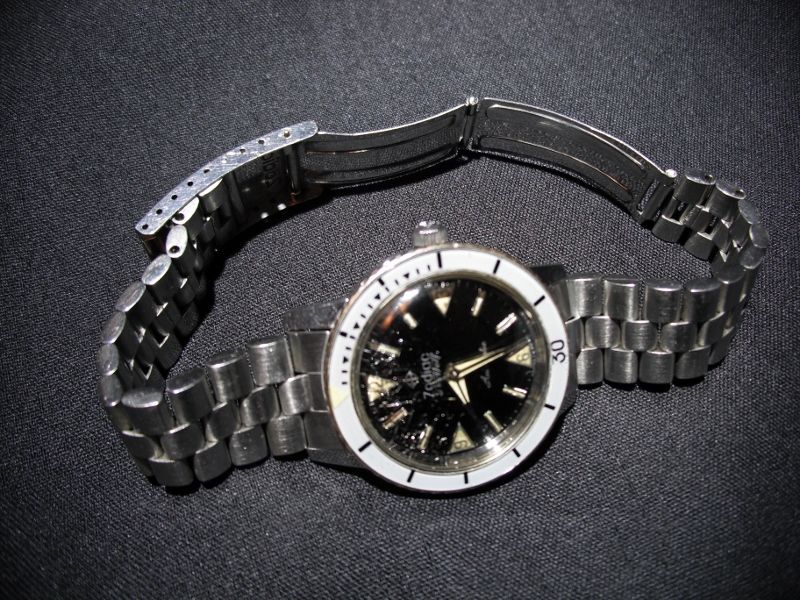

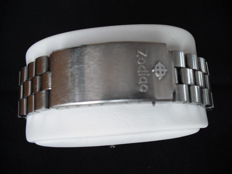

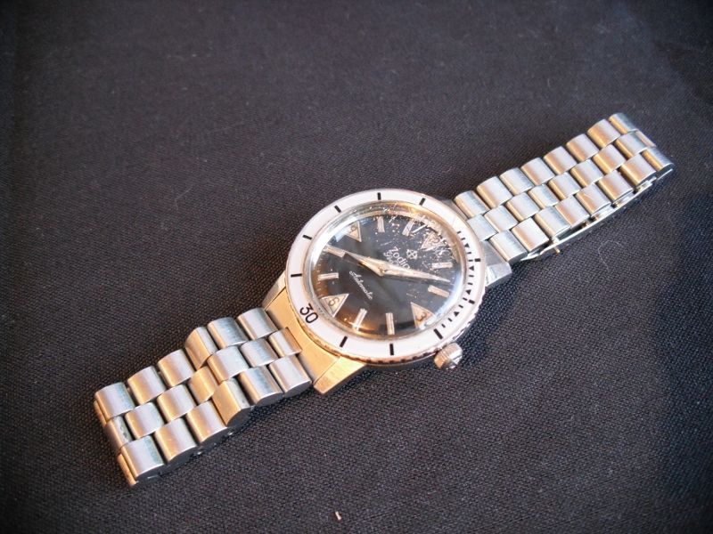

Description of the watch: Black dial with a light blue or pale gray around the bezel. There is no day/date. Stainless steel case, bracelet, and Zodiac signed clasp. Bracelet/clasp appears original and show no real wear or scuffing to speak of, just very light surface hair scratches. The bracelet links surface are brushed, the ends of the links are polished. Bracelet doesn't appear to be stretched out and is in really nice shape, looks similar to Rolex Jubilee bracelets I've seen without the gold links in the center. Case back is marked 20ATM-ESPECIALLY, WATER-TESTED, Zodiac Seawolf, and logo. The Zodiac lettering, logo, and Seawolf + Automatic are done in a fine metallic silver. Hands are silver with luminous inlays, and the 12,3,6, and 9 markers are luminous triangles with the numbers in black. At the bottom of the dial it says SWISST<25MC. The bezel rotates smoothly in both directions. There is NO pitting or scratching on the case, back, bracelet lugs, bezel. The only thing I see wrong is some surface scratches/stress cracking of the crystal, but none of the cracks go all the way through the crystal. The black dial and all markers and indices and lettering are near perfect. Aside from the crystal, the watch appears to have been very lightly used and well taken care of. The watch winds, sets and runs fine, and observing it over the past couple days it is keeping time within 1-2 minutes a day. If I were to rate the watch condition wise I'd say it's an EASY 90%, possibly 95%.

Here are the photos. Sorry for the delay.
As you can see the crystal at the top is the only significant defect I can find on the watch. It's weird, when you look at the crystal in a certain light, you can't see the cracks at all. Again, the stuff you see is NOT on the dial, that's perfect. The cracks are strange. They don't penetrate the crystal all the way through, but appear to go into the surface of the crystal a bit.

 :welc      glad to see a new member! you do have a nice seawolf, original bracelet, no date extra nice dial/hands. bezel also looks very good, plastic insert appears tp be excellent unless there is discoloration/ cracks i cant see. watch ebay, it is an excellent indicator of worldwide selling prices. heed butchs suggestion, if you want it to run and wear it, GET IT SERVICED SOON!!! that is stress cracks in the crystal, these watches have a very difficult snap on back and a lot of people put too much pressure on the crystal trying to get the back to snap in. replace the crystal when service is done, not expensive. i reccomend using our forum watch maker, he is a zodiac EXPERT. contact butch for info. the watch is worth some decent money and if you ARE going to WEAR  it spend the money for an expert service/restoration! welcome to the addictive world of zodiac ownership, you are starting with probably the most popular model, the sea wolf. BTW, from bracelet type and bezel type i would venture to say your watch dates to early 1970s. :wehe
